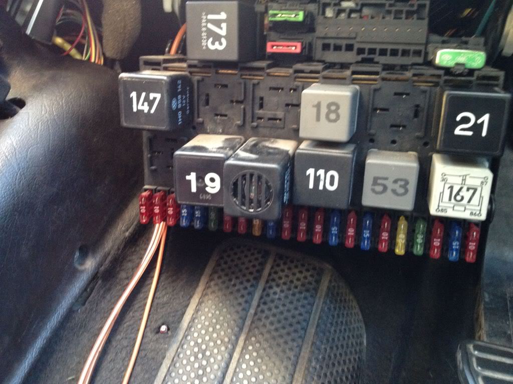

Default power window fuse or relay
i cant find the the power window fuse/relay
any help
Old Jun 2, 2012 | 02:14 AM
Keithuk's Avatar
Joined: Sep 2009
Posts: 2,648
From: Stoke on Trent, England
I don't have access to Autodata at home and I'm on holiday next week but have you Name:  google.gif
Size:  2.0 KB this?
Volkswagen Jetta Fuse Map
http://www.fixya.com/cars/t2022995-1...a_fuse_diagram
VW Golf & Jetta Mk2 Service and Repair Manual 310 page PDF file.
