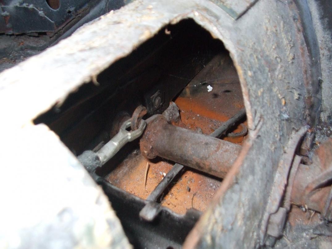

Hi all,
I need some help with a 71ish beetle I'm trying to reassemble. I suspect the accelerator cable is either snapped or dislodged but I can't figure out where on the pedal cluster it attaches (moving the pedal creates a clunking sound in the common tube the pedals use but I can't see an attachment point for new cable). Internet searches turn up pictures of clusters that don't look like this one. Any help would be appreciated.
Cheers
Attached Thumbnails accelerator cable-camera-pics-031.jpg   accelerator cable-camera-pics-032.jpg

found it. On the other side of the tunnel under a little cover.
What type of grease is ok for the new cable though? I have some molybdenum grease here. Would that be appropriate?

yeah, that should work.
