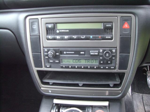

Hi There
Does anybody know the correct buttons to push AFTER inserting the code onto the screen.
This is a Radio Cassette unit installed in a VW Passat.
The button arrangement is as follows:-
.................................................. ......Right hand side of the unit
..........................................FM 1-2............................. AM 1-2
.................................................. ............TP
...........................................CD..... ............................. CC
........................................AS........ ............ SFL.......... SCAN
Left hand side of unit
TRE
............VOLUME ****.....BAL
BAS
RDS
In the cassette slot are written the words
Volkswagen Beta
FORGET ABOUT THE DOTS they are just there for layout for the various buttons.
Any help would be much appreciated.
Tony

NOW SORTED
FYI
Push the > and TP after code
