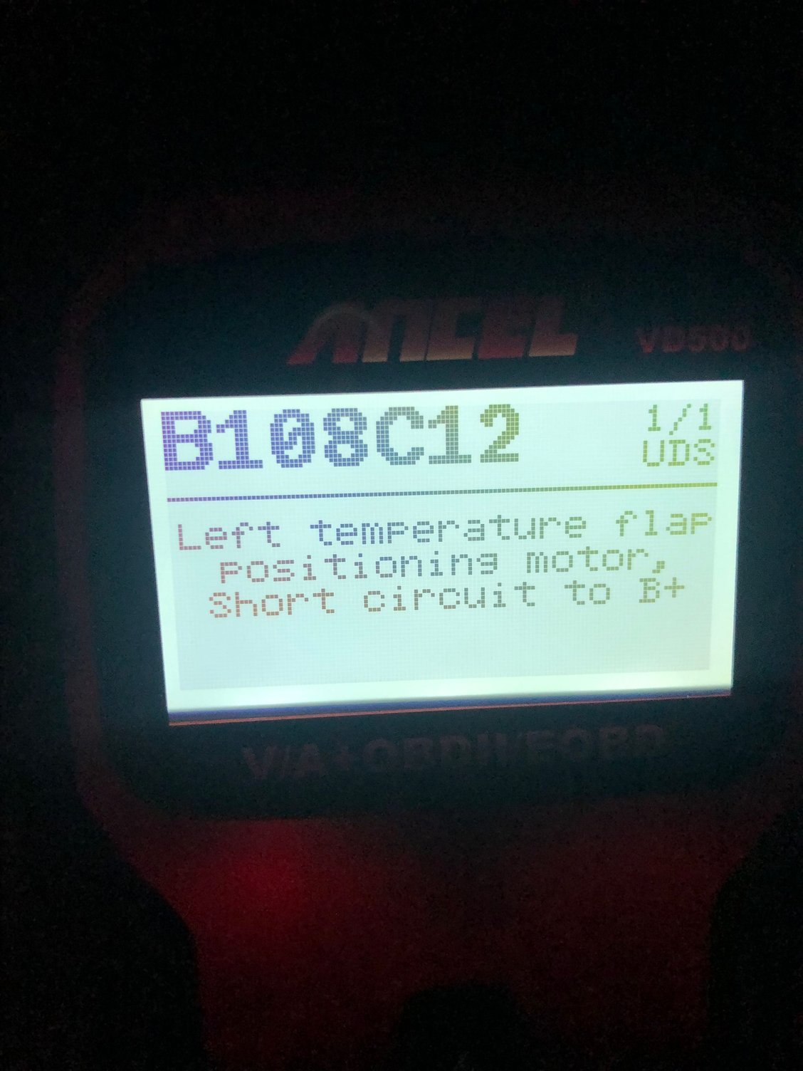

I have been troubleshooting an issue where drivers side AC is permanently on. The first couple weeks of the issue, heat was permanently on on the driver’s side and full temp control on the passenger side. After a couple of weeks, now the air is only cold on driver side, but temp control is possible on passenger side.
Error Code: “B108C11 Left Temperature Flap Short Circuit to Ground”
Error Code: “B108C12 Left Temperature Flap Short Circuit to B+”
I have a few suspicions of the issue that I would like to share. Can anyone provide some knowledge here, especially if you have seen these codes before?
