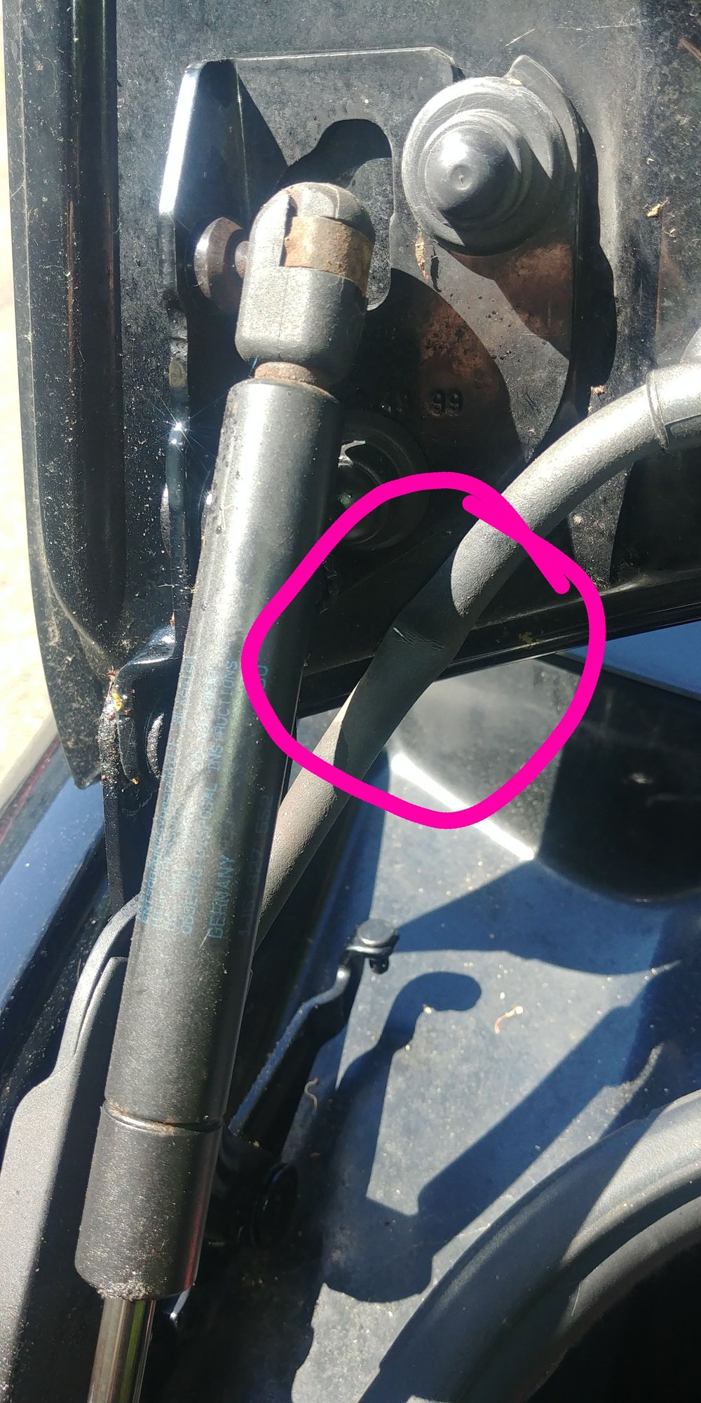

Posts: 33
Default Trunk won't open (2000 vr6) (Not acuator issue)
Trunk issues, blah blah blah.
Bought a new actuator and installed. Worked randomly. Ironically when the trunk is open, but not when closed. After I installed the old actuator, it worked.
See this video:
? He mentions roughly 30 seconds in that the issue was the wire towards the left of the actuator and not the actuator itself. Any idea how I can look into this?

Posts: 33
Not my video.
Do not have access to suggested device. But I think I figured it out. See attached photo. When I moved the wire(s) slightly the mechanism worked (and stronger). But I guess I moved it too much and now won't work again. I also noticed my radio reception has got worse. Related?
Referring to another thread. Will comment there. Many thanks.
