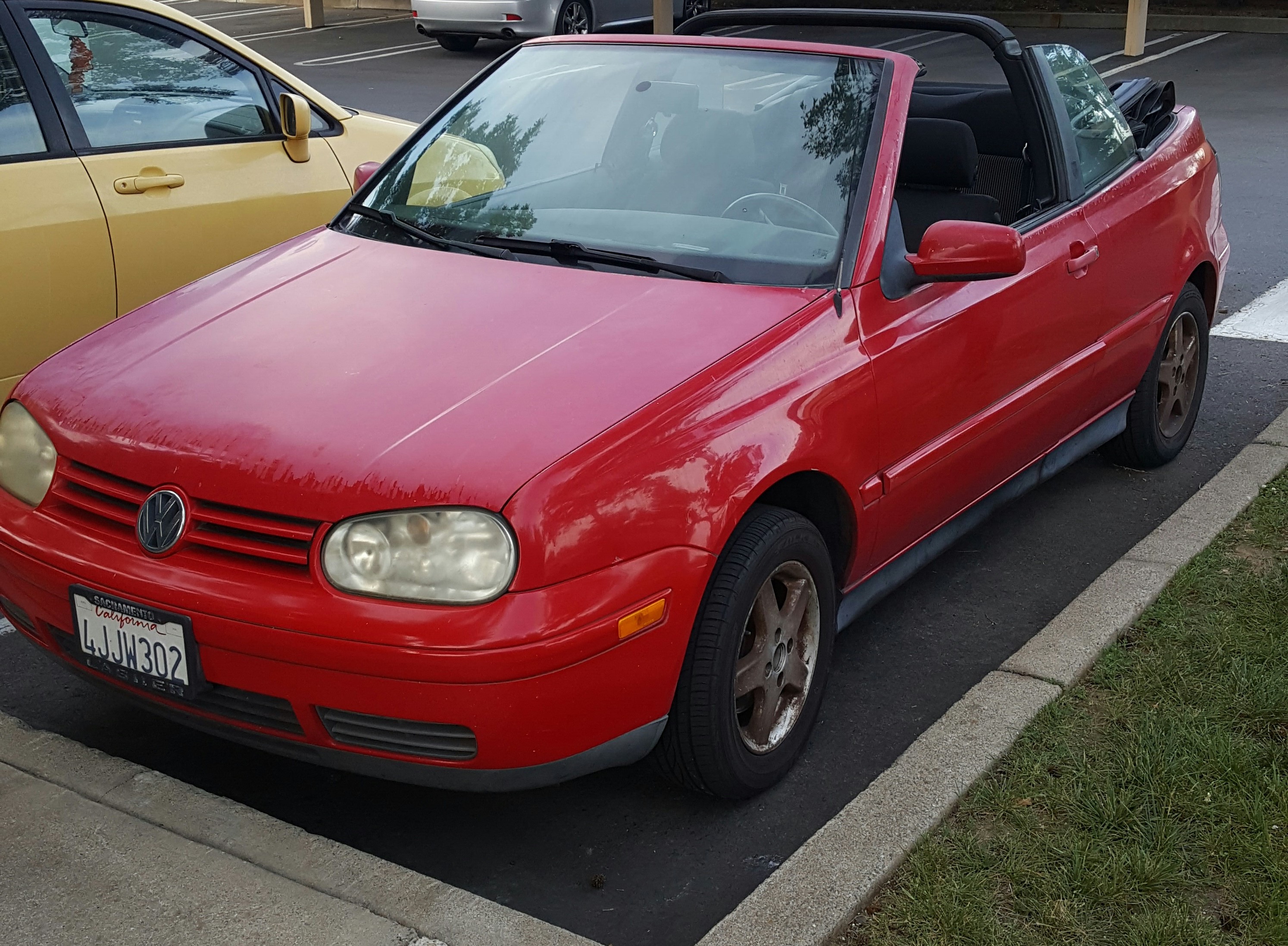

Hey I'm new to the Forum and new to VW
Just purchased this 99' cabrio a week ago today, car runs great, strong vehicle. Love the Convertible for my commute through the back country to work. The Vehicle needs a lot of cosmetic work, and some mechanical. My main issue right now is the Gas tank not filling up all the way, it kicks out the hose handle after about 6-7 gallons of gas. Any ideas on what may be the issue?
would and fuel injector help clean up the gas tank and fuel lines? i'm not sure how long the vehicle was sitting for, it was pretty dirty but runs like a beast.
If i can get help with this, i have plenty of other mechanical questions i could use help with also.
