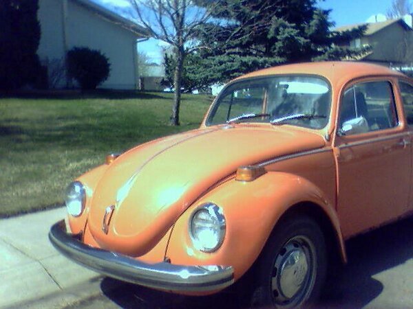

I have my eye set on a beautiful 1960's Beetle, and I'm wondering how effective putting a VW Bus engine would be as to compared to the one already in there. I'm most likely getting a new engine regardless. Also, I've been loving Beetles since I was a little girl, but I'm not very car savvy, so any help would be awesome. The auto I have my eye on isn't mine yet.
http://i2.photobucket.com/albums/y43...mom/lilbug.jpg
Attachment 3976

Your picture looks to be at least a 1968 beetle, I don't know
where other info is comming from but the bus engine was exactly
the same as the bug except for the engine mounts, The bus engine
became a lot larger in later years, but wouldn't bolt into the bug.
The bus engine had a problem with engine block warpage because of it being the same size of the bug and having to pull the
extra weight, the bus was geared down and the engine had a governor on it, but all the extra heat destroyed the bus engine, so
it's not a good idea to do that kind of transplant.
