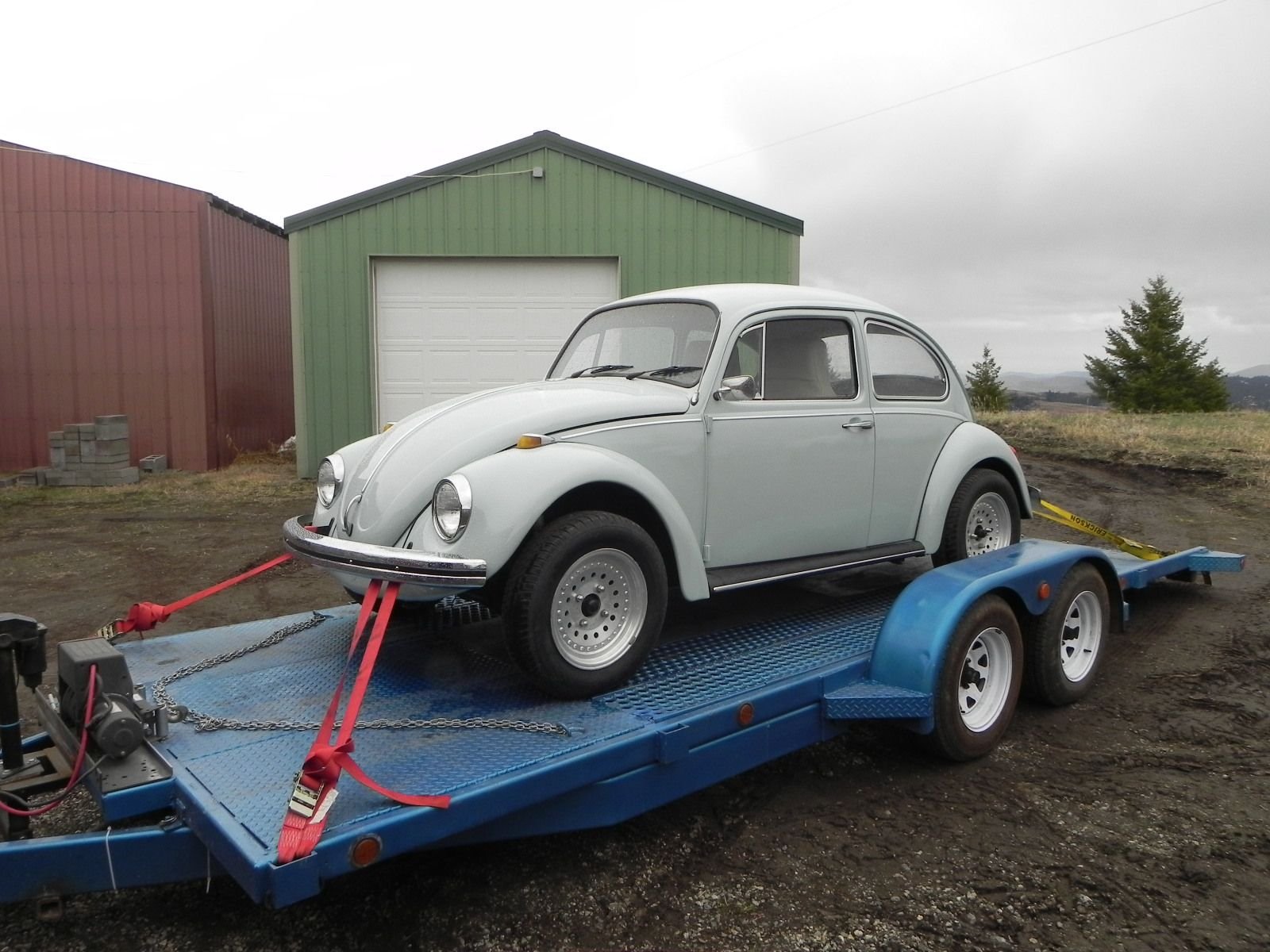

My '69 Beetle runs great, starts hot or cold at 900 ft. When I get up towards my place (4765 ft.) it bogs down & the oil light comes on until I downshift to raise the engine rpm. If I stall the engine it will not restart. I tow it home & the next morning it starts immediately. The question is: What would be a good main jet size to put that engine at around 2500 ft.? I'm guessing that I've got to compromise on jet size to make that car work at all altitudes. I set the timing at low altitude & checked it up at altitude & I didn't see a difference.

Thanks for your suggestions! I checked the timing only because the mechanic at the shop asked me to. The motor is a 1200cc with a Solex H30/31PICT carburetor on it. I don't feel I have a gas supply or spark problem because the only requirement for starting the motor at altitude is that it be cool, indicating to me that the gas/air mixture requirement (choke) is different than for a hot engine. Today I'll pull the main jet, get its number & go from there.
